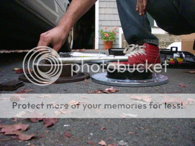

Deal breaker?
Have rear hubs off a B6A4, but apparently they're rather different from B5s (hat offset).
B5 left --> B6 right
(pic courtesy 'wesleyfbm' of audizine)
