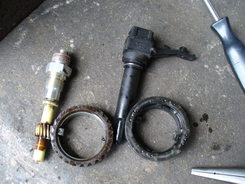

MJF wrote:
What is different when 01E is installed in B2 body? B2 has cable for speedo, what else?
Did you solve this problem?
I think I need digital speedometer from URq :lol:
01E didn't have thread for 016 speedometer sensor and it's dropping in a little too much. :wtf:
