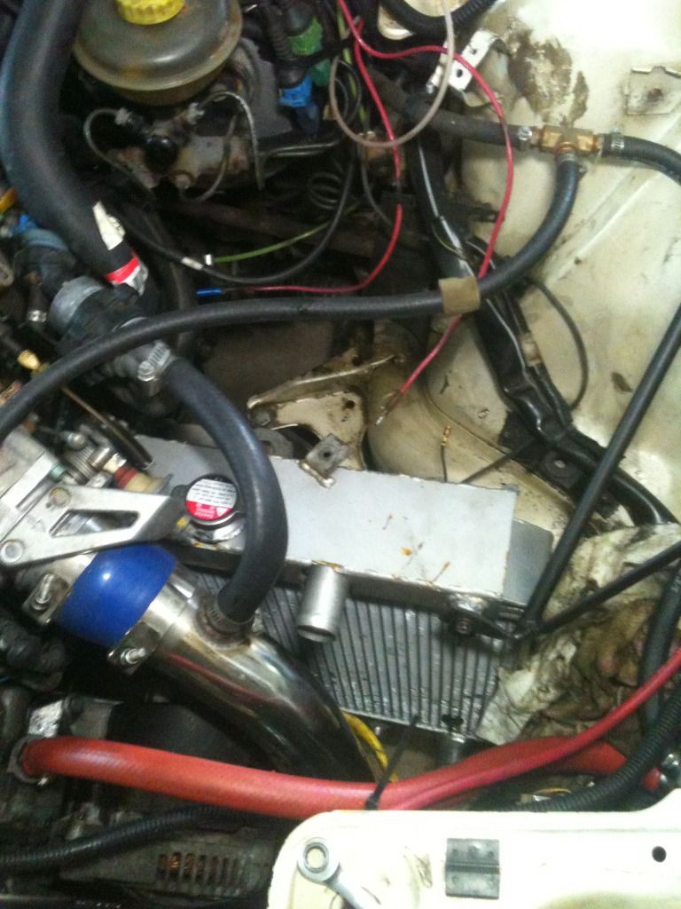

I'm just trying to figure out how that rad actually does anything at that angle with no ducting...

Same thought I had... I'd expect cooling probs without ducting that radiator at the minimum.

I agree it couldn't work well. Until I drive it more, I won't know just how poor it is. Most likely get a scoop and ducting or moved after I find/ modify a intake manifold to make more room up front.

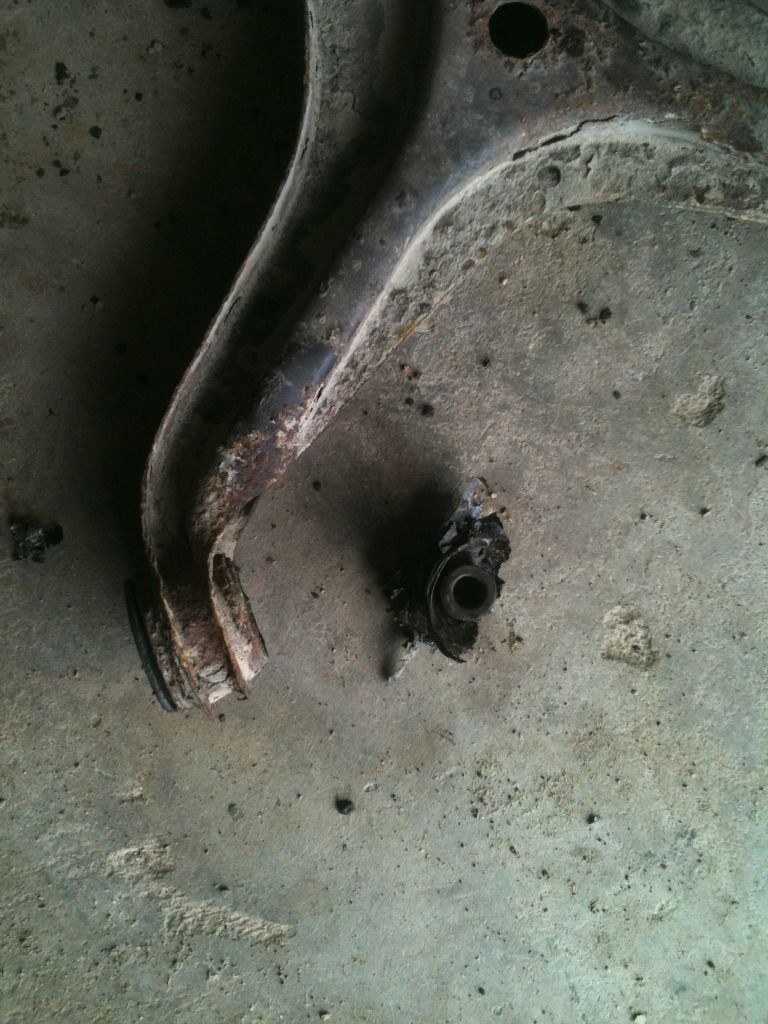

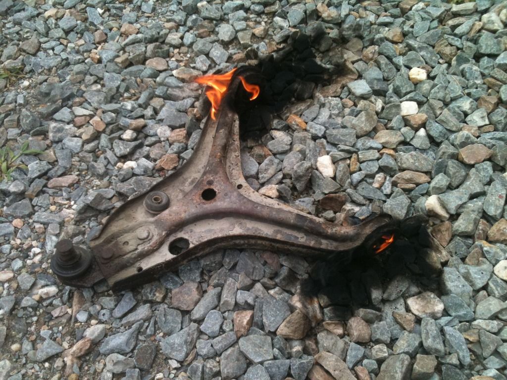

Went to replace a control arm bushing that was VERY bad... turns out it was made of electrical tape :wtf: Decided my control arms are too rusty and should be replaced at some point.
Yum bushing BBQ

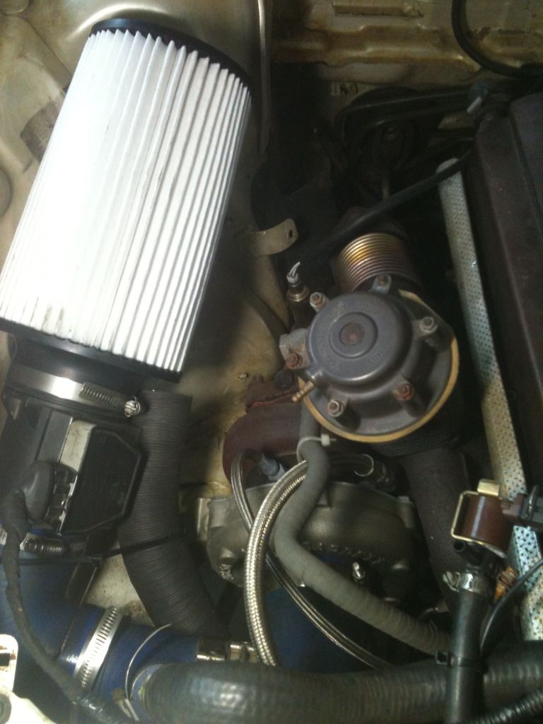

Removed the melting PVC pipe intake in favor of something less restrictive and that I can build a air box around. Plan to feed the box from the lower grill on the bumper. Also started standing up the radiator. Close to where I want it. It too will get most of its air from the lower bumper.

Wow a virgin wastegate cap.
You'd have to be nuts to put melty PVC infront of a nice turbo like that.

Nice, looks like this car really needed you guys! Little does she know the abuse in her future!
Hopefully we will have the opportunity to slay some subies, maybe even that pesky A4.
I'll need to try the fire method next time I change CA bushings, things are such a bitch.

Made a lower radiator bracket today, not pretty but should work. Way lighter then the old one too. Still want to make one for the top and need to piece together some new hoses.
Oh and turn out I can use my boost piping to take the rest of the car apart when I break down :D

teenwolf wrote:
Was the weld backpurged?
No idea but looks like it could have been.
So coolant temps are much happier when driving (190F), but were still spiking while coming to a stop. Turns out the fan was barely even spinning or pulling any air. I rewired that with a rely and now it works great. It did climb as I let it idle in the driveway after a hard drive home. Need to make ducting now to get more air in there.
